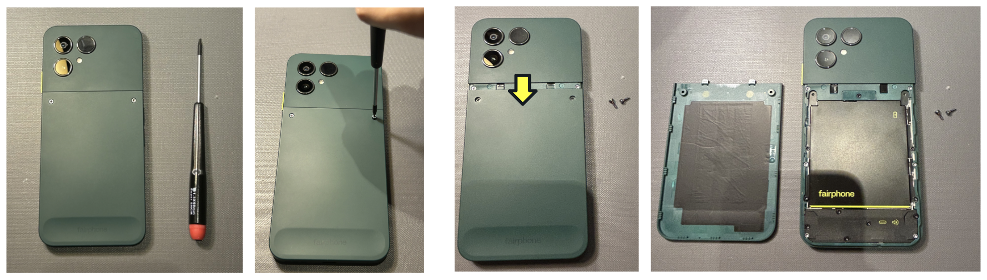

  1. Power off the phone by long pressing the Power button. Depending on your settings, press the Power button and Volume Up button together to open the power menu.
  2. Place the phone on a flat surface with the screen facing down.
  3. Remove the two screws on the top left and top right of the lower back cover.
Outer screws are longer than inner screws. Keep your outer and inner screws separated so reassembly is easy.
  1. Slide the lower back cover off towards the bottom of the phone.

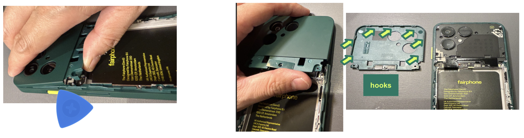

  5. Unclip the plastic hooks locking the upper back cover in place.
Use a plastic card or pick to unclip the plastic hooks to avoid damaging your back cover or fingers. Start from the bottom left and right, then work your way upward on both sides.
  1. Set the battery and upper back cover safely to the side.
Three photographs showing the removal of the hooks in the upper back cover

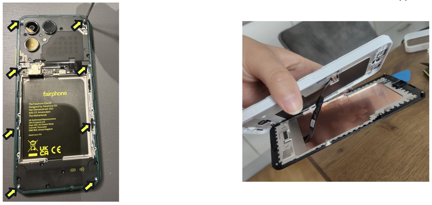

Around the frame, eight silver screws hold the display in place. These display screws sit directly on the frame and are silver in color, distinguishing them from the screws for the loudspeaker and antenna.
  1. With your Torx T5 screwdriver, remove the eight silver display screws around the frame.
  2. Keep all eight screws safely inside your container.
  3. Flip the phone over. The display will be loose, but do not pull it away completely because it is still connected by a cable.
Display showing screw locations and connected display cable

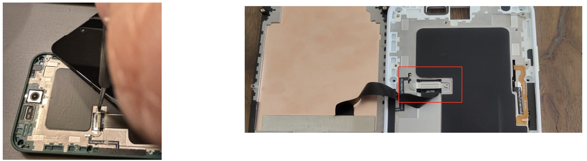

  1. Move the display to the side to reveal the BTB connector attached to the printed circuit board (PCB).
  2. Remove the single screw holding the connector cover in place.
Unscrewing the display cover screw and disconnecting the BTB connector
  1. Lift off the cover and disconnect the BTB connector to release the display.
