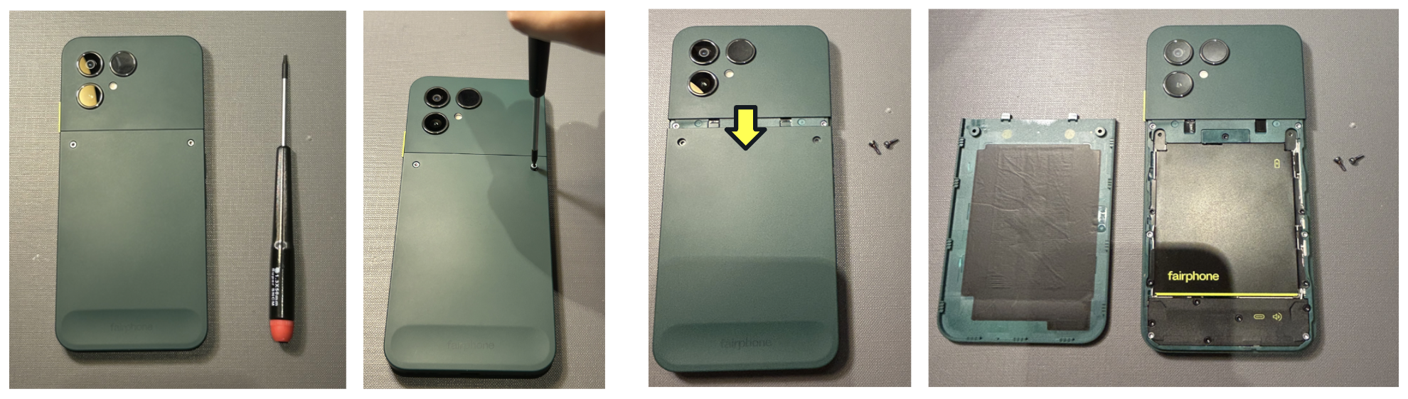

  1. Power off the phone by long pressing the Power button. Depending on your settings, press the Power button and Volume Up button together to open the power menu.
  2. Place the phone on a flat surface with the screen facing down.
  3. Remove the two screws on the top left and top right of the lower back cover.
Outer screws are longer than inner screws. Keep your outer and inner screws separated so reassembly is easy.
  1. Slide the lower back cover off toward the bottom of the phone.
Four photographs showing how to remove screws and slide off the back cover

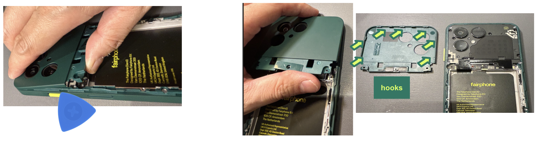

  5. Unclip the plastic hooks locking the upper back cover in place. Use a plastic card or pick to unclip the plastic hooks to avoid damaging your back cover or fingers. Start from the bottom left and right, then work your way upward on both sides.
  6. Set the battery and upper back cover safely to the side.
Three photographs showing the removal of the hooks in the upper back cover

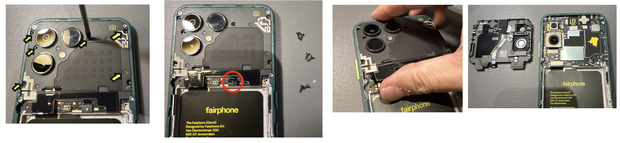

  1. Use your Torx T5 screwdriver to unscrew the six black screws holding the top unit in place.
  2. Keep all six screws safely inside your container.
  3. Lift out the top unit using a plastic card or pick.
Four photographs showing how to remove the top unit

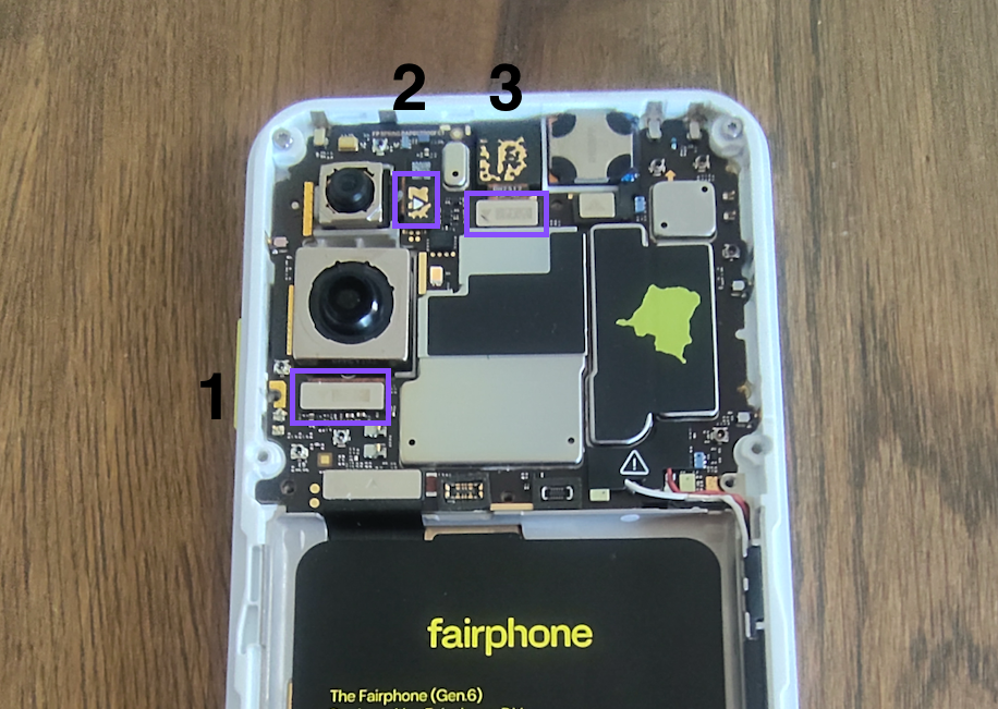

Each camera connects to the motherboard with a board-to-board (BTB) connector:
  • Main camera: Connector is on the left (1).
  • Ultra-wide camera: Connector is above the main camera connector (2).
  • Front camera: Connector is in the middle (3).
Board-to-board connectors for the main camera, ultra-wide camera, and front camera
  1. Use a plastic card or pick to disconnect the BTB connector of the camera you want to replace.

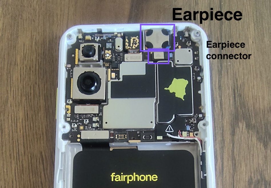

The top purple box indicates the earpiece, and the lower purple box indicates the earpiece BTB connector.
Photographs showing the earpiece and its BTB connector
  1. Use a plastic card or pick to disconnect the BTB connector of the earpiece.
  2. Lift out the earpiece, using a plastic pick for support if needed.

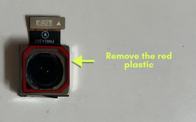

  1. If your new camera has a red protective lining on the edge, peel off this lining before installing the camera.
    Camera replacement showing removal of the red protective lining
