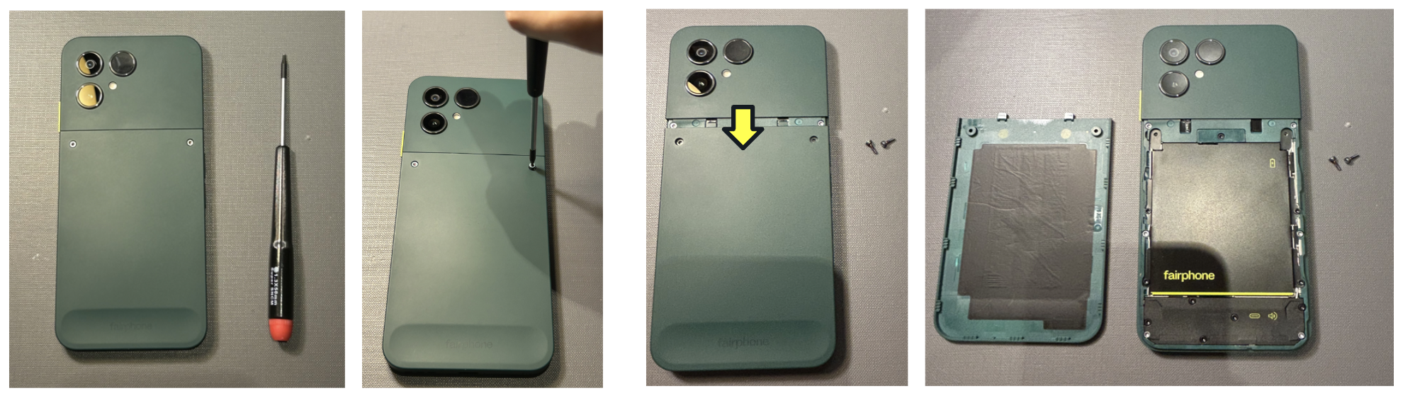

Removing the back cover
  1. Power off the phone by long pressing the Power button. Depending on your settings, press the Power button and Volume Up button together to open the power menu.
  2. Place the phone on a flat surface with the screen facing down.
  3. Remove the two screws on the top left and top right of the lower back cover.
Outer screws are longer than inner screws. Keep your outer and inner screws separated so reassembly is easy.
  1. Slide the lower back cover off toward the bottom of the phone.
Four photographs showing how to remove screws and slide off the back cover

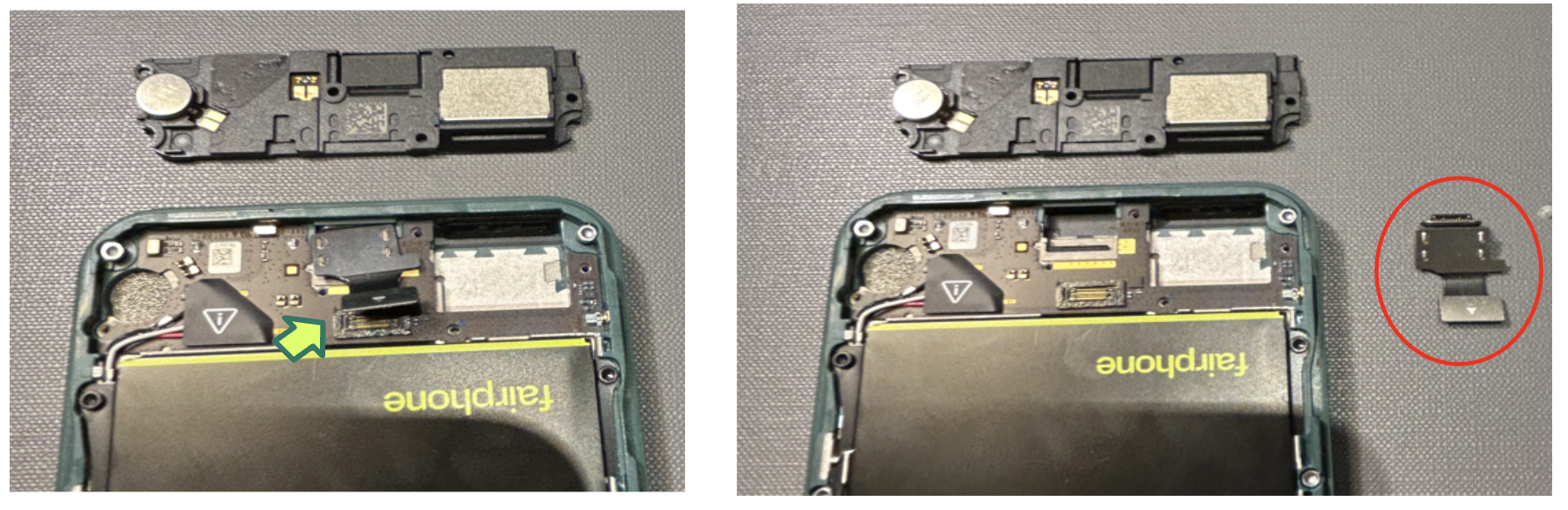

Removing the USB-C port
You must remove the loudspeaker unit before you can remove the USB-C port.
  1. Use a plastic card or pick to disconnect the BTB connector above the USB-C port.
  2. Gently lift out the USB-C port.
Photograph showing the USB-C port BTB connector and the removed USB-C port
