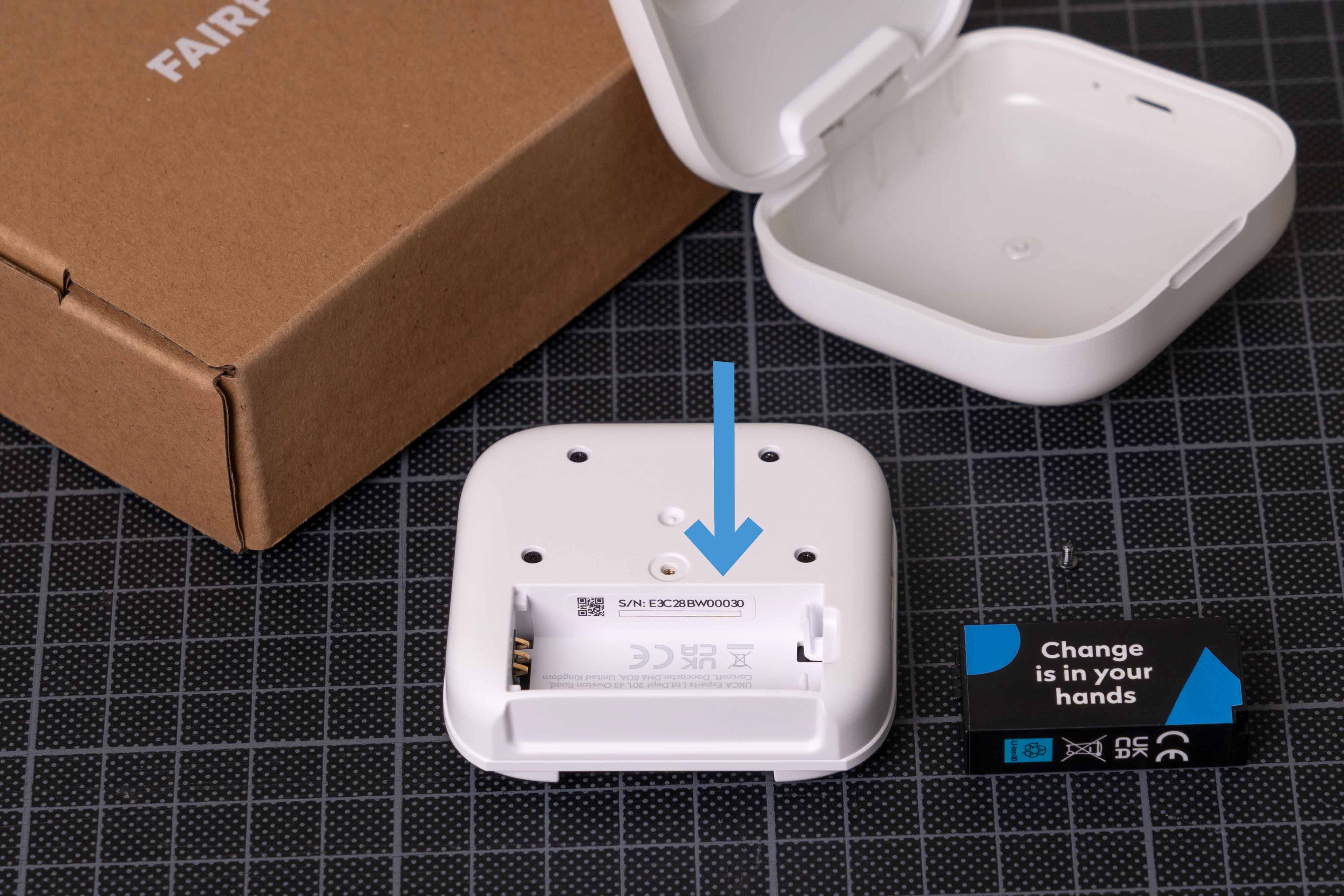

How to find the serial number of your Fairbuds
If needed, you can find the serial number on the original packaging. If you no longer have the packaging, remove the outer shell and battery from the charging case to find the serial number printed inside.
