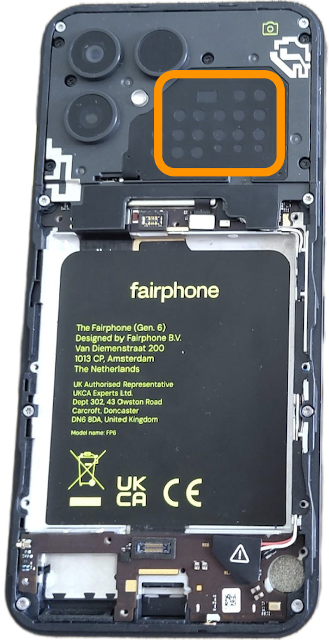

The Fairphone (Gen. 6/Gen. 6) has a NFC (Near-Field Communication) chip under the Upper back cover located on the Top Unit.

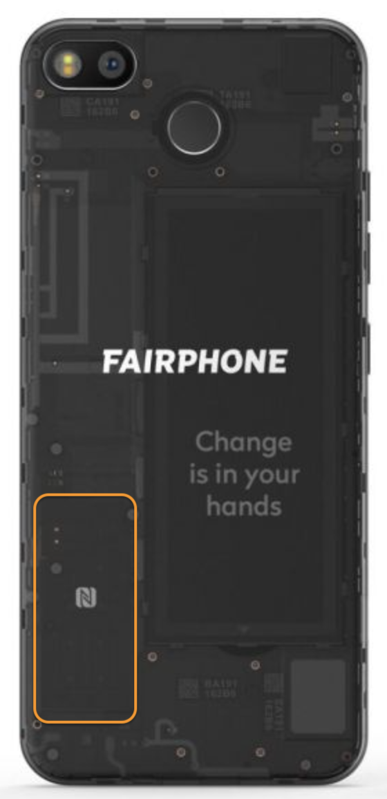

The Fairphone 3(+) has an NFC chip in the Core module, and it's location is the lower left part of the phone, below the icon printed on the Back Cover.
